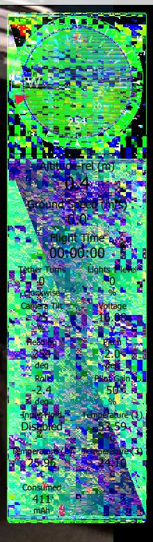

Another issue that happens is if QGC crashes and then restart it, multi colored pixellation shows up on the screen.

The corrupted graphics is interesting, I have never seen this one. Does this happen after the GLib error specifically?

Jacob, after testing again, the GLib error is persistent and not consistently reproducible. It was not an issue in the last version of QGC but had shown up in the version i was using before that. So something seems to have changed between versions.
It does happen before the crash sometimes and then other times happens after the crash. No real consistency, as i have stated.
