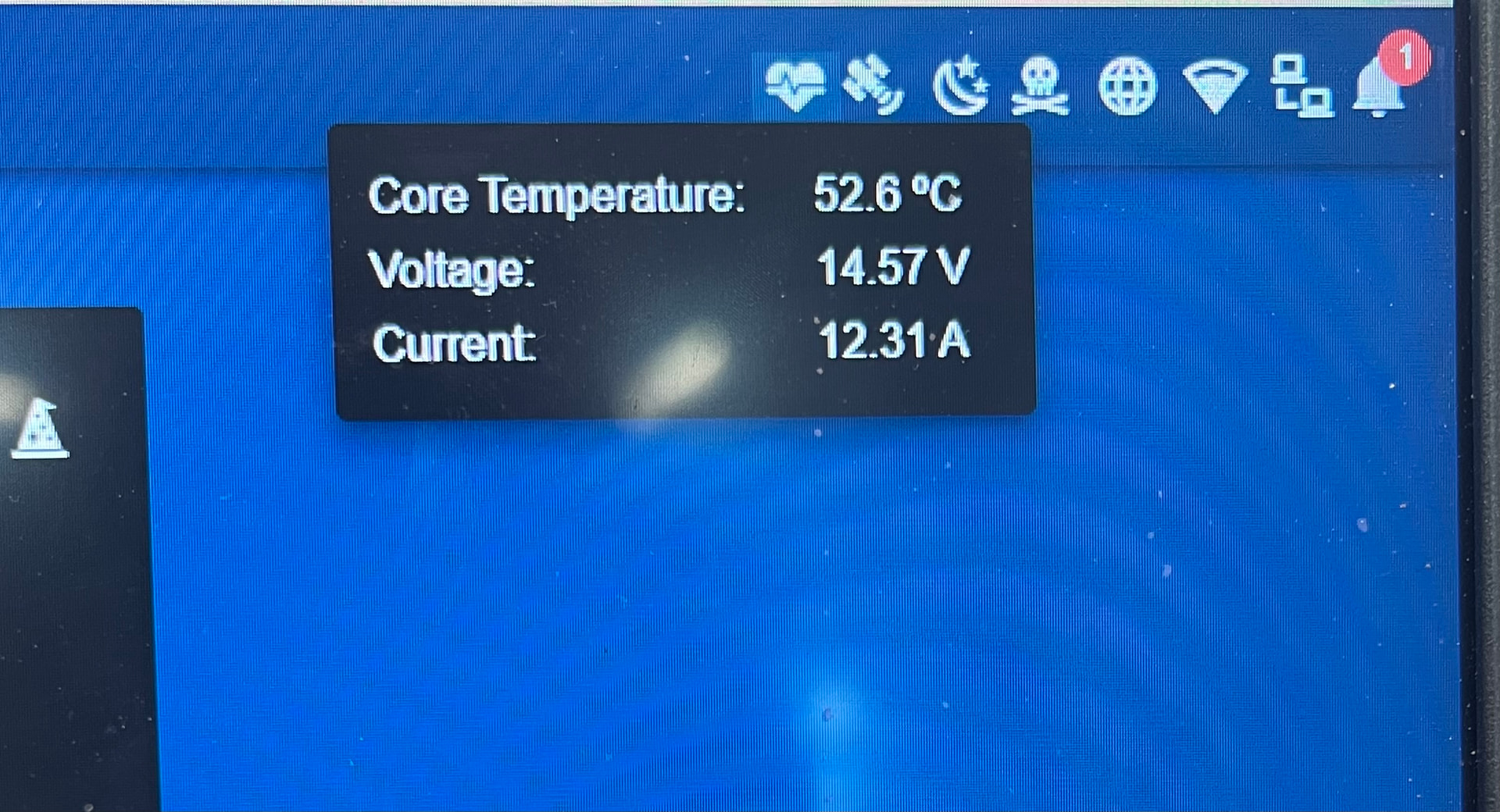

I am currently using a BlueBoat powered in my office by a programmable DC power supply.
I am experiencing an issue with the voltage and current measurements reported by the PowerSwitch, as the displayed values appear to be incorrect.
The BlueBoat is supplied with a constant voltage of 16 V, and the power supply indicates an average current draw of approximately 2.7 A.
However, BlueOS reports a voltage of about 14.5 V and an average current of approximately 12 A.

Measured the input voltage directly at the PowerSwitch terminals and obtained 15.7 V.

Hi @mblais -
When you say
Do you mean you used the calibration extension?
Or are you referring to some other calibration procedure?
If the issue persists, please reach out via the help center, report a problem with a product, and include your order #!
