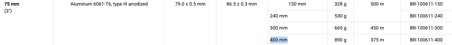

We’ve found an issue with the latest version of aluminum tubes that reduces their rated depth. These tubes can be identified by the two large grooves cut into the inner diameter of the tube. Aluminum tubes are temporarily derated to 50% of their original rating until redesigned tubes are available.
Please refer to this technical bulletin for complete information and service instructions if your tubes are affected.

Yes - the new design isn’t going to change anything about the flange caps - the reason for the derating is the “racking groove”, which reduces the diameter of the tube in some regions along its length, so that it can be suspended during anodization. The fix is just adjusting this, not our seal geometry!
Unless your tube is 400m long, or you anticipate going deeper than 350m,/450m/500m you may be ok?

I was simply wondering what length you were dealing with. If 240mm long or shorter, you could at least get 500/640m, before a replacement with proper depth rating becomes available. Apologies for the hassle!

The racking grooves were added to provide a place to hang the tubes during the anodization process. Previously, the tubes were hung from the edge, which left small marks without anodization. By hanging them from the grooves, these marks were moved to the inside surface instead.
We plan to go back to the previous version of the tubes, which will have a continuous smooth internal diameter without grooves.

Hi @Kansas, I wanted to ask what length of 3” housing you have? We received a small test batch of new tubes which have been tested and approved to 1000m. If we have an extra of the size you need, we can certainly ship you a replacement!

Those CAD files are from October 2025, and do not reflect the revision. Parts ordered today still have the 50% derating - however we are very very close to having 1000m rated tubes once again! CAD files will be updated when the tubes are re-launched.
