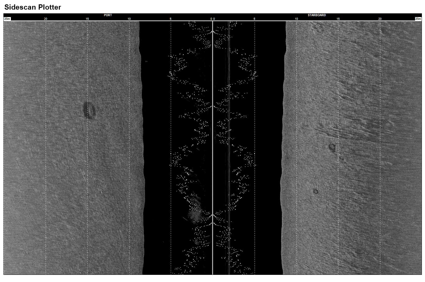

DEEPVIEW SOFWARE
The software was expensive, but it just has a lifetime license so I won’t need to renew it and it sounds like the license will transfer to my future computers as I upgrade my laptop. It also can show a low quality mosaic of my scans on Google Earth, with is great for visualizing how much that I scanned.
The worst thing that I can say about it is that the usability feels clunky like it’s a 20 year old software. For example, There isn’t any shortcut button on the toolbar to add markers. I need to right click on the waterfall and then choose “Set Markers”. Then I click where I want the markers. Then to rename the marker I need to scroll down on the Project navigator and then Right click on the marker name to go to properties. I then can rename the marker. This whole process can take 20 or 30 seconds and during that whole time I’m not watching the waterfall.
The chartplotter is nice since it automatically makes a mosaic and shows the range of my scan while I’m scanning which helps line up following passes so I know if I’m overlapping my scan area or not. Previous tracks are green and the current track that I’m recording is red.

There’s a lot to unpack, but it seems like all up the system works quite well, and the interface is a bit clunky to use but has the functions you want/need from it. The map overlay definitely seems useful for tracking the scanned region, and same for the green/red recording tracks while you’re operating :slight_smile:
I feel like the scan mosaic would be extra useful if it tried to do some kind of meaningful blending of the data rather than just having the most recent scan on top (e.g. convert all the scan data to a point cloud which gets projected back onto the map view), but that’s something for the developers to potentially work on, so is somewhat unrelated to you.

I too find the DeepVision software to be clunky, though I’ve sort of grown used to it now. I’ve never been able to get the layback correction to work correctly, though I can’t say I’ve exhaustively tested it either. One of these days I need to E-mail DeepVision and figure out why it doesn’t seem to be working.
