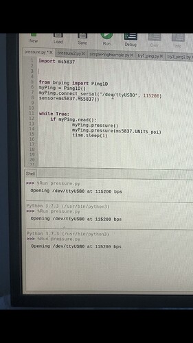

I tried /dev/i2c-{number} but nothing is shown but when I use
ls /dev|grep usb
Is shows
ttyUSB0
As it seas it as a usb
So it shows as serial
I have tried /dev/i2c-{number} but nothing is shown
But when I tried
ls /dev|grep USB
It shows
ttyUSB0
And as serial
What code should I use in this case so I can get the pressure and depth?
From what I can see in your pictures, it appears that your I2C to USB adapter creates a serial port for the I2C sensor, I would recommend to follow the documentation of your USB adapter and modify the library to work with the serial port.
I have tried to use this code but it is not working, could you help me with the code, i need to get the pressure and the depth using the bar 30 with the serial and I have attached the usb documentation. i have tried a number of codes but nothing seems to work.
could you help me with the code?
As I said, you’ll need to follow your adapter documentation to see how to communicate with the serial-I²C adapter. Serial has a different communication concept compared to I²C, so you’ll need to implement a middleware layer to make it work.
