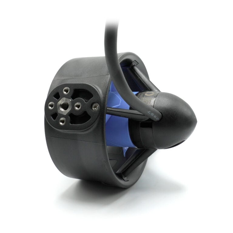

Hi, simple question. On this T200 picture: T200 on BR store the power cable come out of the nozzle and more or less face the mounting braket of the thruster. Is this constant or I can have random orientation while purchasing thruster (like facing the other side)? Can I rely on the orientation in the picture to design a 3d model and plan cable passthrough?

Hi @Charles -
The cable only comes out of the T200 in one way, as illustrated by the pictures and 3D model on the product page. There are no other orientations available!

I’m not sure what option you’re after, but you can do rotate the inner section steps of 90 degrees like this, by undoing the screws around the outer shroud (if that’s what you want to achieve).
