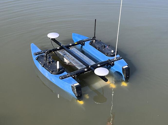

For a project, we have ±3m/s current. We have equipped the BlueBoat with an ethernet current sensor, RTK positioning and survey software on a Windows PC. Experience shows that with our setup we can handle 2,5m/s of current.
To be more manoeuvrable we would like to add two extra M200’s. Extra batteries will power these motors and the extra ESC’s, the PWM we ‘copy’ from the existing BlueRobotics Navigator.
We are aware of the M500 solutions (see links), but M200 we have them in stock and easier for spares and swapping.

Thanks for the reaction and thinking along! We have a Teledyne RDI RioGrande with a printed fairing around it to reduce drag!
4x M200 setup would be:
Mechanical-wise, it feels solid!
For the project, we think that even with the increase in weight (batteries, ALU bracket), the increase of thrust (Kgf) will be sufficient to handle the 3m/s with more ease.

That’s a slick design! The additional thrust may get you to that speed, but it’s difficult to predict. Definitely share your results!
You may want to reduce the surface area of the horizontal plate? How do you plan to attach that cross member to the hulls?

Test bracket details. The dent in the mid, is to create some stiffness.

We performed the test, and here are some figures! According to the Cockpit speed pointer, the max speed is 2.5m/s. We did not use a spring balance to measure the Kg force!
Quite happy with this setup!

Overview:
Forward, backwards, full speed etc.
Propwash:
Hi @Willem -
Congrats on your integration! I’m not quite sold on it - doubling the power consumption for a 1/2 m/s reduction in top speed (and likely a big hit in efficiency at 1m/s) doesn’t seem worthwhile, but it certainly increases the tow-force you can bring to bear…
