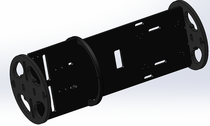

On the topic of improving an already great product, I am finally going in production of my prototype for this middle bulkhead project I have been wanting to do for a while now.
This will address a few issues:
  • 24 penetrators in total (All threaded in)
  • Possibility to add an aft camera
  • More space in the enclosure
  • Enclosure is secured with bolts
Making the first prototype with 6063-T6 aluminum and anodized blue.
I strongly suggest the use of a tail whip for the tether connection on that one :slight_smile:
More info here: 4inch enclosure middle bulkhead - Upcoming Products - Delta ROV Forum
The o-ring flanges will be available separately.
