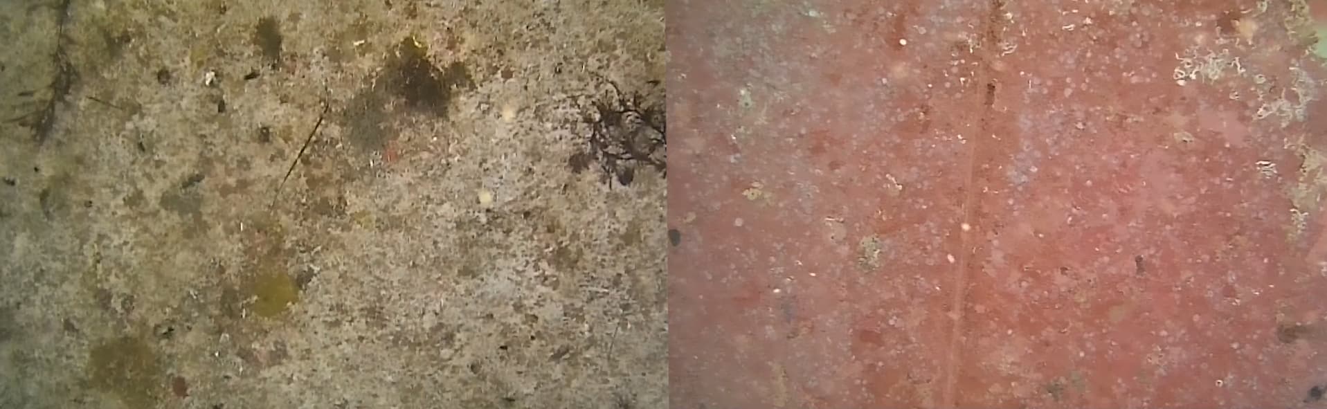

I wanted to share our latest ROV for ship hull cleaning equipped with a water jet. Last month, we tested it on a ship and got some great results.
we developed a docking and hybrid crawler mode. When the ROV reaches the hull, it switches to a vertical position to stick to the surface before starting the cleaning process. Once attached, the hybrid mode between the crawler motor and thrusters takes over, allowing the ROV to move under the ship and perform cleaning easily. Right now, we’re working on a lawn-mower motion to automate the process.
I’m still looking for the best sensors and ideas to fully automate the cleaning path. If anyone has experience with similar automation, I’d love to hear your thoughts!
I’ve attached a video showing how it works, including the docking and cleaning process, along with before-and-after shots of the cleaned surface. Let me know what you think!

Thanks! The automation is meant to assist the pilot rather than make the system fully autonomous.
There are a lot of challenges when cleaning a dirty hull. I don’t think a camera-based system would help much since the onboard camera gets blurry during cleaning due to all the debris in the water.
Our crawler motor has an encoder, so for now, I’m considering implementing a simple motion pattern, like a rectangular cleaning path, but the main concern is motor drift and slip.
Our ROV only uses a water jet—no brushes.
