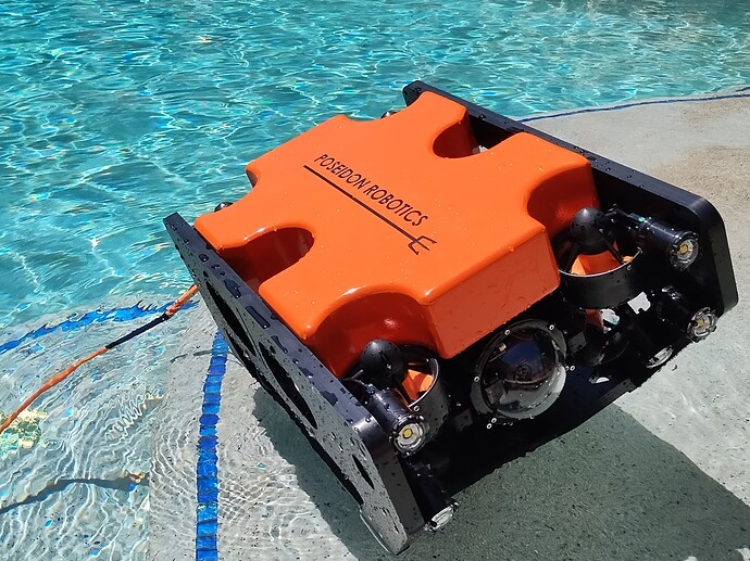

It’s been almost 4 years and a couple dozen builds since we first launched our Lanai Pro ROV and this latest revision is the best yet.
Here are some of the latest updates:
  • Polypropylene frame (3/4in thick) for added strength (you can stand on it)
  • 3.0kg of buoyancy in fresh water
  • Slightly larger frame easily fits larger sonars
  • Light JBOX and fuse protection means one damaged light won’t take out the others
  • Mission Robotics flight computer enables smooth 6 degrees of freedom
  • larger reel now easily holds 300 or even up to 500m of our 9.3mm OD tether
  • Mounting bracket fits Ping360, Micron, or Echologger sonar
  • Power supply under the buoyancy, a fully open deck for gear and accessories
  • Surface power runs on 90 to 264VAC input.
We’ve already shipped a couple of this revision and will be doing a lot of demos this summer. Please check our website for more details.
