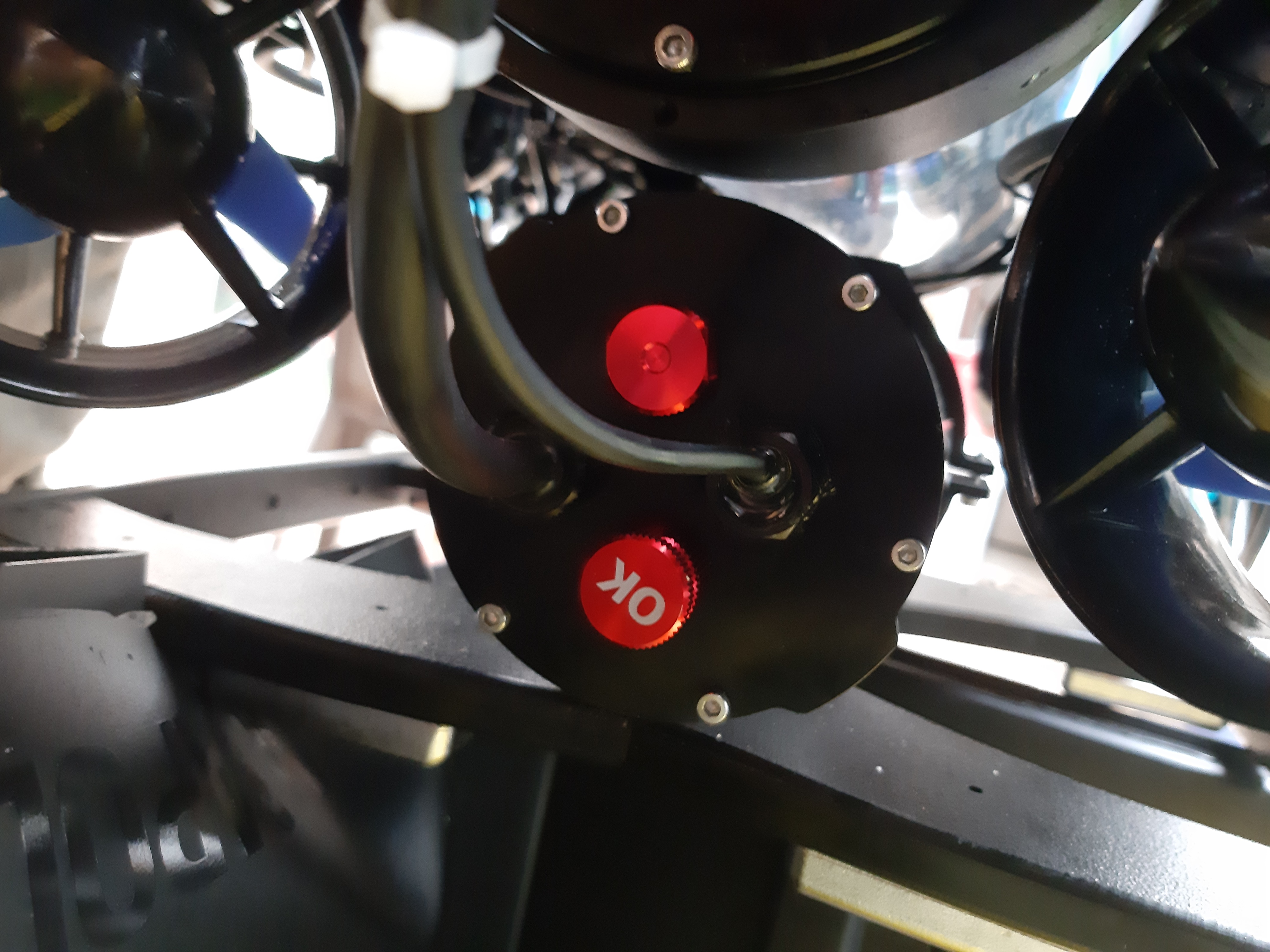

Hi,
I manage to ensamble 4 units of the Lasers redy to install on Blue robotics ROV2.
the laser need 3.5 Volts, I took 14 volts from the LiPo battery on the ROV and transformed with DROK BUCK DC CONVERTER,
I have 3 pieces available, If you need one please send me a email to luis.chavez@24marine.com
Here some pictures of How I have Installed,
