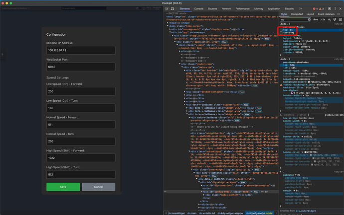

On the other hand, a black rectangle appeared in the top-left corner of my screen. It appears to be the configuration menu of the widget. There seems to be no way of closing it now :sweat_smile:
@alexgosleep a tip: if you just remove the top and left CSS attributes from the config-modal element, it will work:
Yoo rafael, thanks for the tip!!
