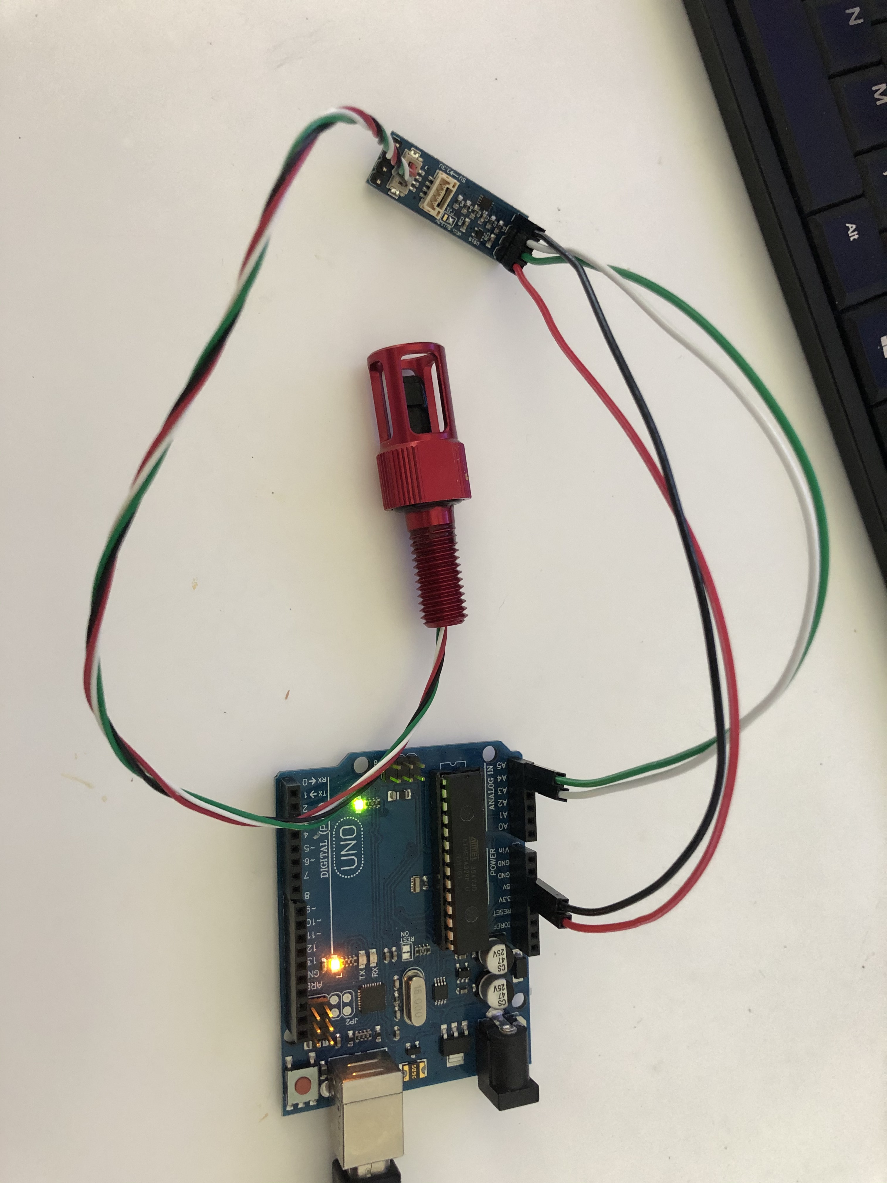

Hi all, I have a Celsius sensor connected to an Arduino Uno via a BR logic level convertor. When running the standard example sketch I am getting air temperature readings about 1 to 1.5 deg higher than expected (checked with a K type sensor). I am careful to ensure that the sensor is away from the micro controller and any possible heat source.
Interesting when I handle the sensor there is an obvious thermal storage/release effect where the senor readings increase for few minutes after I isolate the sensor (i.e stopped holding it) and then the readings slowly fall at a rate of 0.01 deg every 20 s. The base readings always tend to be 1.5 deg above what is expected.

Pic of my very basic setup
