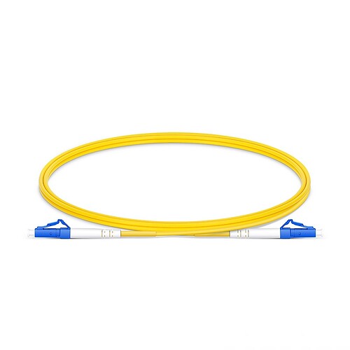

We used this optical fiber.
They can also make custom made items over 300m.
You need to install the SC connector yourself after through the penetrator.
Unfortunately I don’t know the ROV fiber optic creation tutorial.
If you need a tutorial, I may be able to post it, although it will take some time.
I apologize if there are any mistakes in my English.
From the description it is clear that this cable - 2 and 3mm in yellow insulation is intended for indoor use only. What’s your experience with this cable - how durable is it? This cable is very light and cheap, but I am afraid that, for example, if the ROV catches on a branch with this cable and pulls, a loop will form and the bending radius of this loop may be 1mm or less - this means a breakdown of the central fiber and loss of connection?
Certainly this fiber optic is for indoor use.
However, I have been using it for more than 60 hours so far, but it has not been broken due to environmental factors. (I once got caught in the thruster and broke it.This can be prevented with proper care.)
Attaching a small float to the fiber dramatically reduces the chance of getting caught.
I thought that the fiber optics had neutral buoyancy, thinness, and low cost, which outweighed the disadvantages.
If you recommend optical fiber, please tell us.
Thank you!
In fact, I’m sure this is the optimal fiber option because the other options are more difficult to use. For example, in Russia, in addition to such a yellow and cheap fiber, we also have black ones with polyethylene insulation. Two thin steel wires (0.5mm) are laid inside the black insulation. This PE cable is for outdoor use, but it is heavy, very stiff and more expensive. And for ROV, the weight and flexibility of the cable are of critical importance. Thicker cables are more difficult to carry. I ordered a yellow cable in a 1 km long bay the other day. This thousand meters of fiber weighs only 7 kilograms! I gave a little less than $ 100 for this bay, along with shipping. Let’s see what happens.
I have a small piece of this yellow cable and I understand that it does not sink? I think that positive buoyancy is not always useful - for example, the cable can be cut by a motor boat or a jet ski. Ideally, the cable should probably sink slightly and not sink to the bottom, but hang in the water column - i.e. have neutral buoyancy.
So far, I’m only worried about the fragility of the fiber if a loop is formed. I used to think that the fiber is plastic, but the central part is most likely made of glass.
