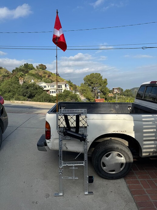

Hop-n-Bob is a sort of drop camera I built, partially using BR equipment. I take Hop_n-Bob out on my sailboat off Redondo Beach, toss it overboard and let it sink to the bottom. There it takes pictures and short video every 10 seconds. Every few minutes, it uses its thruster to Hop to a slightly different location. Eventually it drops its ballast (which are salt blocks for cattle) and returns, Bobbing on the surface. This is the 3rd in the Bob series. While it is limited by its instrument housing to 750 MSL, recent improvements include a lidar, and its Arduino Nano BLE provides compass, IMU, internal temperature and pressure data. Syntactic white foam is used for flotation. The camera is an old GoPro in a competitor’s rectangular housing mounted on one of the legs. The white light pictures are with the LEDs on; the green light pictures are from the glow of several fishing lure lights. Pictures below.
