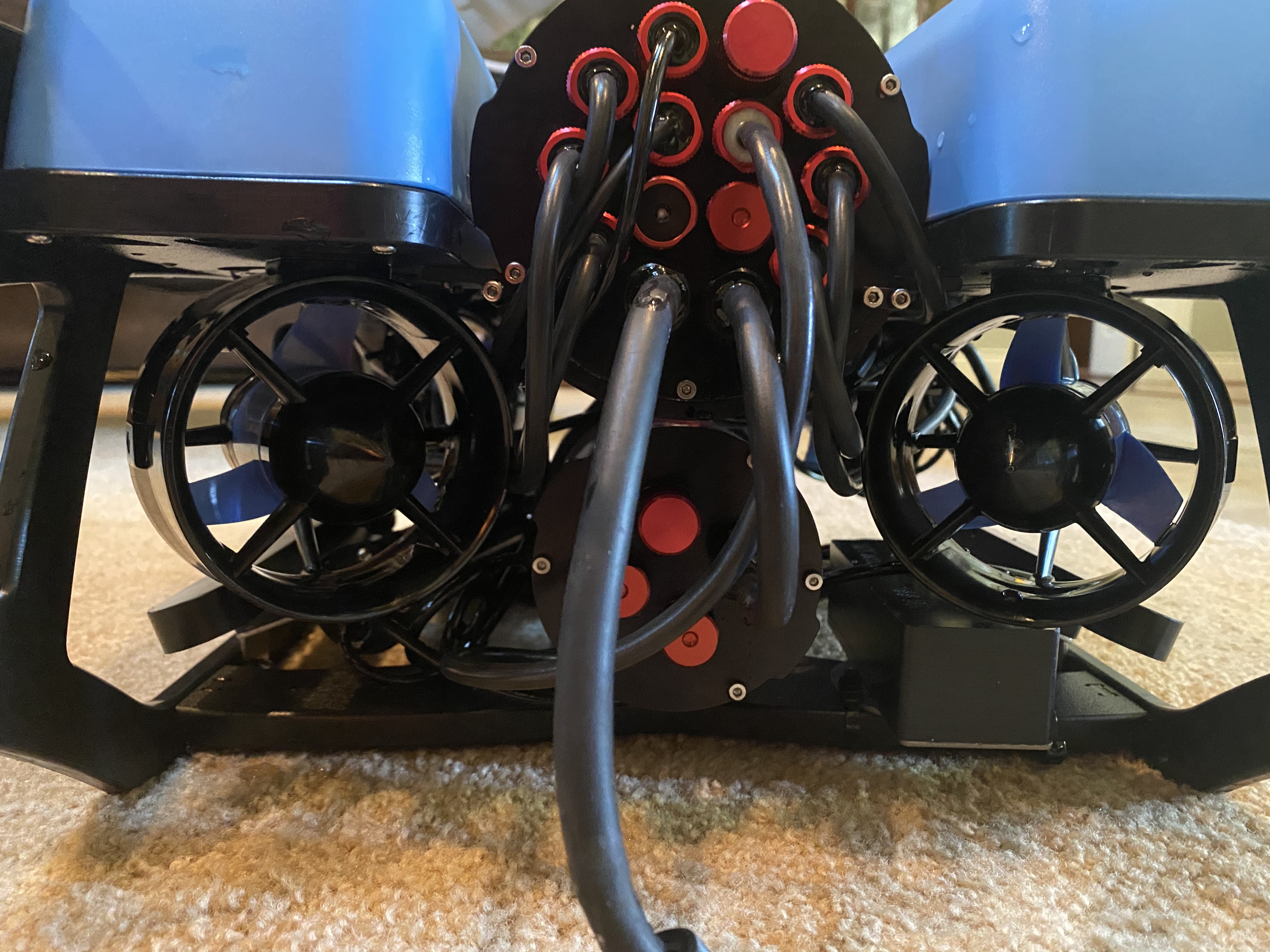

I just got my ROV back from a buddys house. I put it in the water today for a test… all it wants to do is make a left turn while I am trying to go straight. and it also wants to pitch up and blast to the surface like a sub doing an emergency blow.
is there defaults for where my tuning should be to start fine-tuning it? right now everything looks like it set right down the middle on every setting.
Hello @AmphibPS,
I believe what you seeing is not an issue with the tuning itself, but misconfigured motor directions/frame.
Check the Configuring Motor Directions section on our docs.
I have checked the thrusters mounting and blades… all look good to me. im going to take to pool in the am and run the autodetect in the thruster setup.
