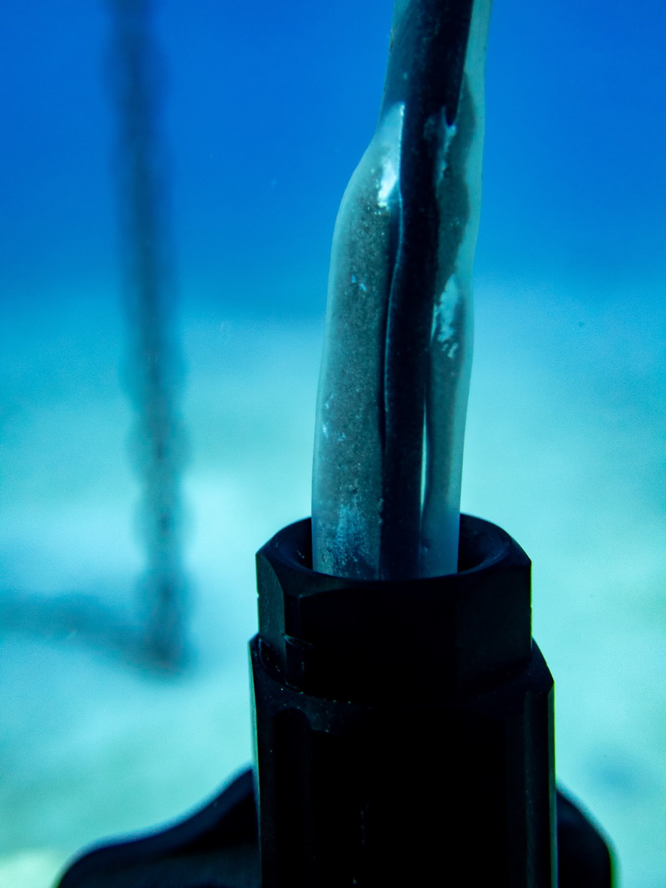

In a moment of inspiration, I grabbed some two-part plumber’s putty and formed the same half-cylinder shape along a short (~1.5") length of the cable. It has about a 3-minute work time before it starts to harden, so after about 2 minutes I pulled some clear heat-shrink down over it and hit it with the heat gun. With a gloved hand, I pressed the hot heat-shrink tightly into the putty, rolling it between my fingers to get it feeling as round as possible.
The cable’s rectangular width was about 7.5 mm, and since this was a generally sketchy solution, I opted for the taller HC plug to compress the seal. I waited about 10 minutes for the putty to harden, then tightened the plug into the seal on the modified cable end.
I did this on both ends of a ~1 m length of cable (cut from the excess we wouldn’t be using) to make a test article for sanity-checking the approach.
:diving_mask: Taking It for a Dip
I plugged both ends into a WetLink splice kit and took it for a scuba dive (with the T500 DPV, of course). After a quick stop at 150’, I stayed just inside the no-deco limit to maximize time at depth on the return. No bubbles ever came out, so I wasn’t surprised to find no water in the enclosure once I was back at the car!
clear heat-shrink used to visualize potential leak path
The test article is now hanging at ~25 m at the farm. If it stays dry inside after a few days, we’ll go ahead and install the new camera system!
